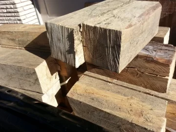

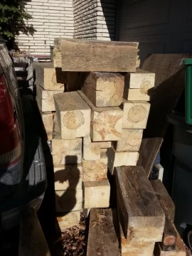

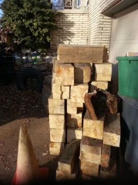

Picked up a load of these, old barn beams I think. Put one in 8"X8"X16". 4 hours later the stove was still at 500F.
