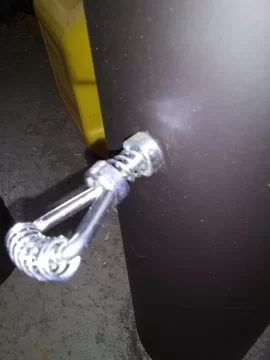

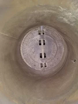

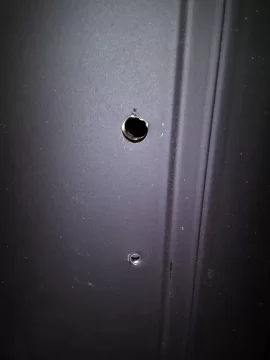

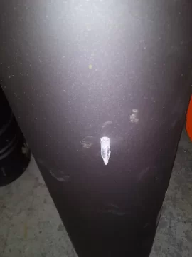

Just an FYI: here are a few pictures. They will give you a better idea of the holes I placed in my double wall stove pipe. The temp probe pic is the same size as my manometer hole.
I added fender washers and small pieces of sheet metal to cover the open area along the damper shaft in the first picture. I do not have a picture of the washers installed. Also visible in that picture is the inside of my temp probe hole.
