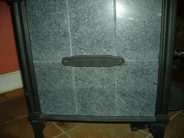

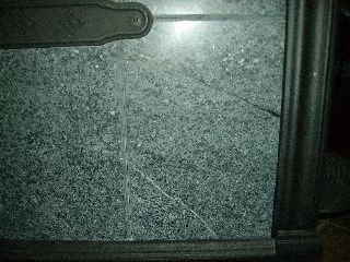

Here are the pics. First is a wide shot, second a close up. Hope they are not too big.
Not sure if this qualifies as a 'hairline' or not.
Wife asked, "why are you taking pictures of the stove...?" So the cat's out of the bag. She is as thrilled as me to see this expensive purchase with a crack in it.

That is worse than I had thought. The dark stain around it makes it look much bigger than it really is and if it dries out then the crack may be difficult to see.
It looks bad and that's enough to tick me off. The bottom of these stoves are notoriously cooler than the top so perhaps after a long fire it will dry up.

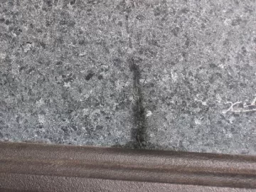

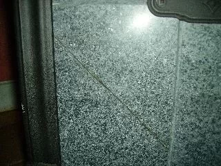

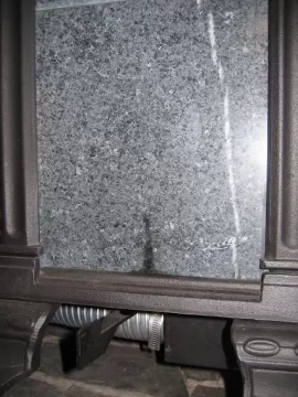

I can understand you being upset. I was extremely vigilant in doing my break in fires. I did quite a few extras even but I still had a crack appear near the middle of the season and then another at the very end. It looked very suspicious and dark like wood ash as you can see (actually looks a lot worse on camera). I continued to use the stove as it seemed just fine otherwise and waited to do a thorough inspection when the burning season was all over. After cleaning out the stove I could not see or feel the crack on the inside. I got lazy about it but after seeing your photos I thought it best to send some pictures and get it on record to my dealer and go from there. I do know that right where each of those cracks are is exactly where there where pretty straight white veins in the stone. I can still see some of the white vein at an end of one of the cracks. I am surprised how yours has so much dark around the crack itself like the stone is very wet. Let us know how you made out and I'll give you my follow up also. Best of luck to you. I know this is frustrating but it happens to some and from what I hear Hearthstone will take good care of you.
