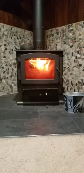

I read somewhere that the OAK helps with negative air because it is drawing from outside not inside, also seen a couple of stove setups on youtube where the OAK is higher than the inlet (not saying that installation is correct). The house is pretty leaky, that is why I installed the stove in the first place. I do have a shaft door in my utility room I could crack open that would draw cold air from the attic, but no windows to open. This install below is one I have seen.
