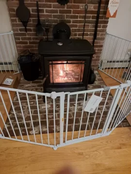

I'm trying to figure out the best way to install an OAK with my current setup. The OAK connection is below the stove and not pictured here are 2 windows about ~36" beyond the brick hearth.
[Hearth.com] OAK Install Location
Is there a basement or crawlspace below the stove?
It can't take combustion air from the garage, but it could be connected to an intake vent on the garage outside wall through the garage using the appropriate piping.
