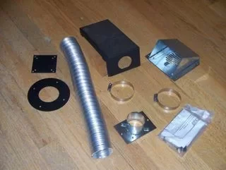

Quad requires adapters to properly attach their OAKs the last I knew.
There are pictures on the forum of some of them (and there is also one where someone did the installation wrong they put it on the back of the stove).

Not so fast there Pete, Quads require adapters to do the job, the OAK is not to be attached in the manner which the OP is thinking.
I have pictures in my owners manual that show a collar coming off the rear panel which a 2 inch flex duct gets connected to it. I will post a picture of it when I get a chance.

Pictures Of The Kit And Installation For Santa Fe
  • [Hearth.com] OAK - My dealers perspective.
