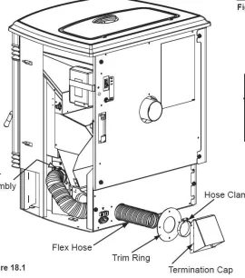

Not so fast there Pete, Quads require adapters to do the job, the OAK is not to be attached in the manner which the OP is thinking.
Yes, this is the way the OAK is to be installed on the Santa Fe (see installation diagram) and why use the OAK if the cold air is just going to get sucked out by the convection blower for this particular model. Bad design.

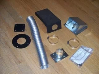

gerryger said:
Pictures Of The Kit And Installation For Santa Fe
That nice dark air channel goes where?

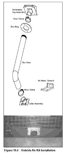

I stand corrected. The image below is the correct way to bring an OAK into the Santa Fe. My previous image (from a downloaded Santa Fe manual off the web) must of been for a previous model of the Santa Fe. I feel a lot better that it is directly connected to the combustion chamber. A design improvement by Quad!! Now my decision for an OAK will be easier because of this. The older method just didn't make any sense.
