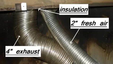

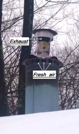

Here are some photos of the exhaust and fresh air lines of my Quadrafire Castile pellet insert.
The Fresh Air line goes up the chimney only 2 feet in length and was insulated below to keep out the cold air from mixing with the circulating air inside the unit.
On the roof, the cap was installed above the original one, so the exhaust ends above the fresh air inlet. I hope these photos help.
