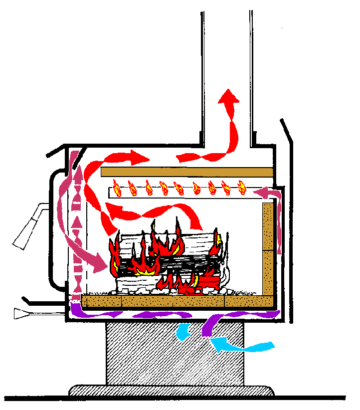

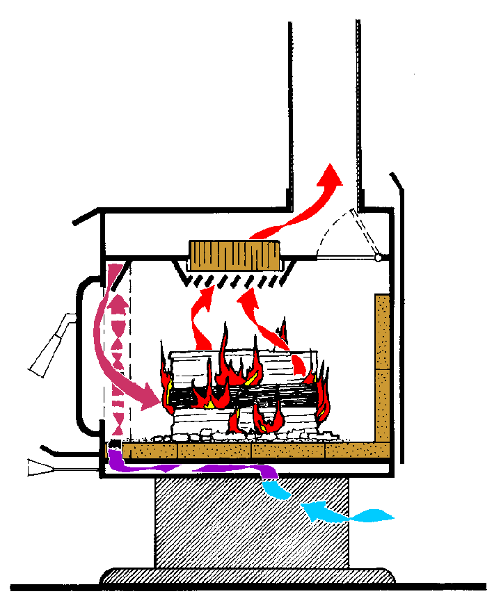

I also may be wrong . . . I thought woodstoves with cats (as the OP mentioned) did not typically produce secondary flames (although I know some folks have seen some secondaries on occasion).
It doesn't? So how does it burn/consume the gases?
Similar to a cat in a vehicle I believe (I've never had one though), the catalyst causes a reaction at high enough temperature. There is no secondary air in a cat stove, except for a hybrid like the Woodstock progress stove. And similarly a stove with secondary burn tubes doesn't have a cat, instead secondary air is preheated by usually channeling it up the back of the firebox then fed into the firebox under the baffle.
I suppose this could be a terminology problem... You could sort if say the catylitic combuster is 'secondary combustion' as primary would be the burning of the wood in the firebox. But usually secondary is reffering to stoves with the burn tubes that feed in secondary air.
Interesting. Just read this:
http://woodheat.org/how-epa-certified-stoves-work.html
I wish I could see the catalytic converter in action. Sounds like the gases still burn, you just can't see it. From the diagrams, kind of seems like the baffle/non-cat stove would have better draft. It seems to heat the exiting air more. Non-cat stove would kind of take some of the enjoyment away. I love watching the secondaries going.

You can still have good secondaries in a cat stove, mine has nice ghost flames as the smoke ignites trailing down from the cat. This is an example from a blaze king:
