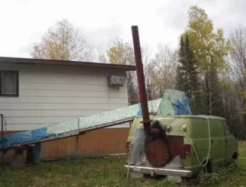

Waiting for the attached photos of the ridiculous burning appliance setups. My favorite was the van...
Reactions: theora55
The van! The van!
[Hearth.com] Oh, so thats how I should set up a stove!
And another quality install using dryer duct as fluepipe!

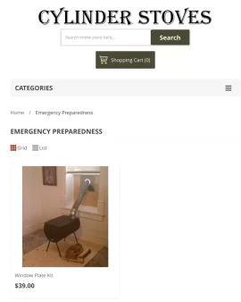

I am not surprised at someone trying to set one of these up for an emergency.
I am a bit surprised that some company actually sells this kit with the galvanized pipe and shows you a picture of how to set it up in your house. I guess Cylinder Stove does not have a lawyer on their payroll because it looks like a very expensive lawsuit in the making.

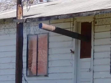

I wish I had stopped and taken a picture of a house I passed in Maine a few years back.
6" stove pipe exiting the window about 2 feet away from the side wall where it then turned 90 degrees vertical and up for maybe 4-5 feet to a rain cap. The front of the house was covered in creosote and black soot. It looked like a fire waiting to start.
Reactions: theora55

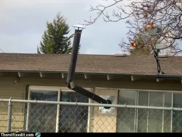

That guy isn't alone
And at least he had a vertical AND a rain cap
