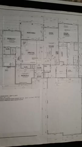

Attached is our floor plan and a recent house pic. I plan to place stove pipe 19" from each wall which will provide and extra inch or so beyond the minimum 17.875". Wife doesn't want any backer behind the stove so it will be painted drywall. This measurement should automatically satisfied the minimum 6" side clearance for a corner install right?

All the 30 stoves have 4'' clearance to corners as opposed to 6'' for the 20 stoves. And because the 30 stoves are only a couple of inches larger, their foot print is only marginally bigger than the 20's. In the space you have, I'd go with the 30.

I wonder if the 30 will drop right in the same spot as a 20. I don't have a lot of wiggle room to move the prospctive chimny because of a LVL beam for a tray ceiling.

The Chinook30 is 17 5/8'' to center of pipe and the Sirocco30 is 18''.
The Chinook20 is 17 7/8'' to center of pipe and the Sirocco20 is 18 1/2''.
