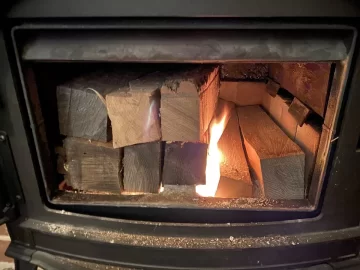

Hi. I know BK basically wants folks to not poke their fires, but is that under no circumstances whatsoever?
It's just that sometimes, there are "husks" of half burned log splits that don't burn all the way through. Usually, I stack it right and it's not an issue but like in this photo I am showing on the left side, a big split is not burning through much, sometimes, it happens. I just want to poke the whole thing so it burns down evenly.
BTW, I do start a fire, then leave it on high for twenty min's before turning down.

No problem. Disengage the cat, wait a min or 3, poke til your hearts content, close door and reengage once the dust settles. I usually open the door just enough for the poker to fit through, to keep as much heat in the box as possible.

The middle always burns out first on mine too. Then I have two separate fires. Once each of those becomes just a single remnant it stops burning so I usually have two femur sized remnants to make part of the next load.
If you just can’t resist fussing with it, I don’t see a problem with opening up the stove for some poking.

Thanks for the replies.... I thought maybe it has something to do with sudden shifts to the catalytic burner that wasn't good for it?
They say not to open the stove or poke the fire until it's time to reload on this BK video anyway (at the 10:28 second mark):
For sure it’s a negative thing for your catalyst to open the door because it introduced a rush of cold air in the vicinity of a hot cat. Thermal shock to some degree and that damage may be small with each hot door opening but it’s not zero.
Really, do you think you’re accomplishing anything by poking? So long as the load mostly burns up by the end it’s fine to just let the thing run.
Reactions: BC_Josh and Ashful
I sometimes put some kindling or a small split in the bottom sides. That burns away early, leaving some extra air space which helps to reduce the tendency for the fire to separate in the middle. Usually I don't bother; the separation doesn't cause a problem.
The center portion of the load burns out first in my King. I use a poker and move everything to the middle and reload large amounts to each side and also on top of the hot coals. Makes for easy transition to continued operation. If you plan on lettting the fire go out, you can also just turn up the thermostat and that will burn the sides down faster.

It is only on a rare occassion that I have some log splits off to the side that really aren't burned through very much. Thought it would be nice to poke 'em occassionally.... but I hear ya; the catalyst doesn't appreciate the cold air... ok. Thank you. BUT.... (I say but).... sometimes you want to light another fire when the cat thermometer is still at mid point, but there are hardly any coals... So, I'm assuming at lower temp's the cat is OK to open the door.
As noted, center will burn through first, but all should be consumed. If stove dies with any serious chunks left behind, it's a sign you're trying to burn too low and slow for your conditions. Those "conditions" include your draft and quality of wood.
As noted, turning the stove up when you get down to these last remnants is a good way to continue getting as much heat as possible, while ensuring they're completely consumed. The thermostat moves to open air a bit on its own, as the fire wanes, but its movement is much more limited than what you can do by turning the knob.

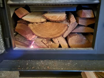

Ok, let's revive the Blaze King wood stove tetris challenge. I'll start it off...KE40!

Just stuff it full. It's not about total weight, but density of the photographed load!
No, no, no. First, you need square splits to really pack it. Second, you need oak for max BTU's! ::-)

Here's a pic snapped the other night, but I guess I should've finished loading before I took the photo. ;lol

Triangles, rectangles, and hexagons pack much better than circles. Everybody does triangles, and rectangles aren't hard. There should be major bonus points for anyone using hexagons.
But for max BTUs, it may have to be NIELs shaved to rectangles. Anybody who does hexagonal NIELs automatically wins, and we take up a collection for therapy for their OCD.
