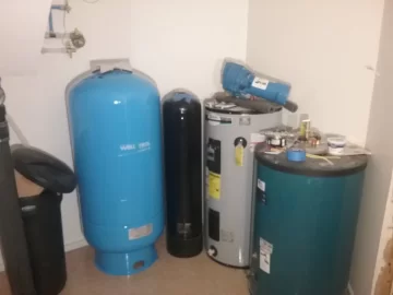

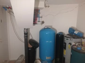

Ok u guys place/ grade my mechanical room layout
atvalaska
Jul 22, 2014
116
nenana
Don't know where I should of posted this but u will find a snap shot of items in my house/ mec room ...do I cut in my wood fire boiler 1st than my summer time back up electric...with heat traps ?
  • [Hearth.com] Ok u guys place/ grade my mechanical  room layout
I’d do the boiler first, then prioritize items in order of flow from the boiler. Less pump, pipe and insulation that way. The pics don’t leave much working room
