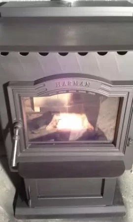

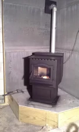

As a result of a kitchen remodeling, the boiler got moved to the P61A location & the P61 got moved to a diagonally opposite corner in the basement. New 12" hearth riser built. Walls dura-rocked in preparation for new tile or stone or a combination of both. Outside air not gonna get hooked up til I figure out where I want to punch a hole thru to the outside. Got a "slip" section in the vent that'll give me about 2" of adjustment to accommodate the new finish material. Unit serviced & painted. First bag is in. Fire is burning. Ready for "The Hawk!"

Very nice Daksy. Looks Super!
Did you build the raise Hearth? I have to do one just like it. 12" high wow, very nice!
Anymore pics of the Hearth building? Looks great!
Looks like its going to be a nice layout, but why so high of a raised hearth? Stepping up, pouring pellets in with a tight area around your feet, with a warm/hot stove, might be kind of a pain?
It's 12" high , actually 11.5, the height of a 2 x 12 with 1/2 plywood & 1/2" durarock on top.
I started with a 44" square layout, & lopped a corner at 22" & cut the outer ends at 22.5 degrees.
Measured & cut the lop section with 22.5 degree ends.
I ran a 2 x 12 41" across the entire inner width. I cross-braced with 4 2 x 6s.
Cut the ply to 44" square & laid it on top of the box before marking for the lop cut.
Added the durarock, cutting one length to 44 (x36) & marking the underside similar to the ply.
Cut an 8 x 44 strip from another piece of durarock & marked that the same way.
I shot the framing with my Paslode nailer & screwed the durarock with 1.5" coarse thread
square drive concrete backer board screws.
The 12" height gives a "nicer" flame presentation & makes servicing the unit easier than it was on the floor. I can climb up or I can pour the pellets in from the floor.
