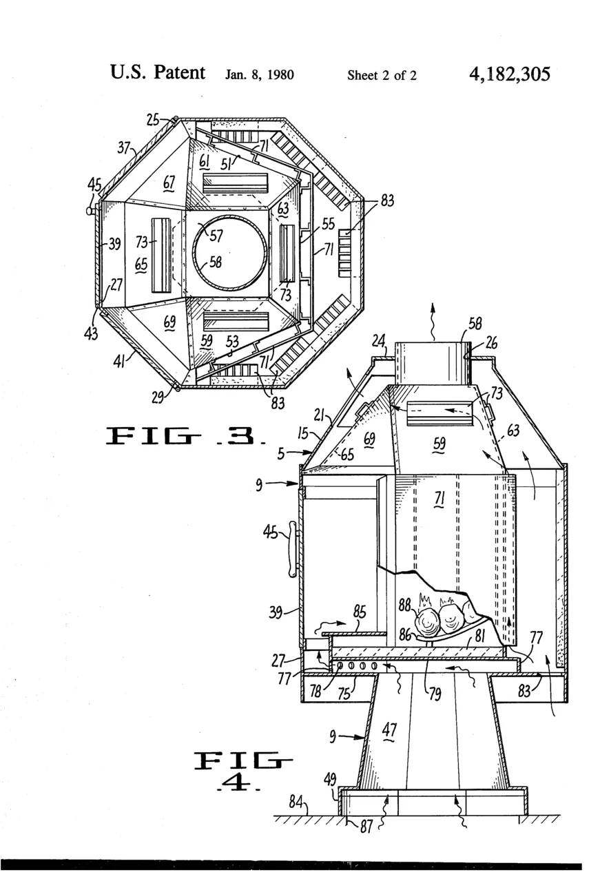

Essentially it's a pre-EPA (80s) wood stove that's a little funky. Pretty much the only references I can find to it online are the patents that were filed: http://www.google.com/patents/US4182305
It's an interesting stove. Essentially it's a sheet metal octagon that's supposed to draw input air through a hole in the floor instead of from the room. It has a two layer shell and a blower that pushes air from the room between the two layers.
That being said, it doesn't look like there's any hole in the floor through to my crawlspace and basically no attempt was made to design this thing airtight - there's big obvious gaps around the doors and even hinges that let air in from the room.
It does have a lot of charm, and it is already in my living room. I'm an engineer, so there's a big part of me that wants to seal it up and build some air injection or a catalyst into it. There's tons of space to work with.
What do people think? Is it a fool's errand to make this thing workable? Should I just find something to replace it with?
Welcome. It looks like a freestanding fireplace with a convective jacket. Is that a fair assessment? From the picture it appears to be unbaffled and no secondary combustion. Adding these feature and firebrick or vermiculite side panels should help but they bring up other questions like airwash for the glass and is the glass tempered or ceramic?
Yeah, that's a pretty accurate assessment. Definitely unbaffled with no secondary combustion.
However, the way the air flows, it comes in through the pedestal then out holes at the base of the windows - sort of like an airwash.
I see. It looks like sealing up those hinges would take a door redesign and welding. Quite frankly if the goal is clean efficient heat with a nice fireview that can be done for under $1000 and the results will be more predictable. Otherwise I think I'd just enjoy the nice unique fireplace as is.

Yeah, redesigning the doors would be required - I guess that definitely takes it into project territory... Worth doing more for the experience than the cost.
