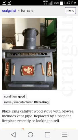

My mom and step dad have an older BK princess I do believe. Non cat but looks identical to the one on the pic of the Craig's list ad below. I can't quite make out the model number the seller sent me a pic of the tag on the back that says cat stove but I can't make out the model. I'm curious if first off what model it is. Secondly I don't see a bypass handle to verify the cat and I don't wanna drive 2 hours for nothing. Like was there a " bad year" or a design flaw or something when BK first changed to cat stoves

Princess has four holes in the base, King has five. Can't see it in any of those pics.
Bypass handle is visible in the pic of the side of the stove, though a bit dark.
Looks to be in pretty nice shape.

Ask the seller to read and provide the model number from the back tag.
I'd ask again telling them that you can't read the model number due to glare.
With the manufacturing date of 1983, it is a pre EPA model. Second, it is either a PEJ1000 or KEJ 1100. Neither of these two were EPA approved.
The combustor design has greatly improved over time resulting is longer life and less maintenance. If you wind up buying the unit, be advised that some states, regions etc. and even some insurance companies are not looking for EPA certification.
Buyer beware....
Buyer beware....

I'd wait...unless it's $250.00 or less.

Doesn't have to be EPA approved to have a catalyst. Phase I didn't take effect until 1988, stove was built in '83.
You really think BK would have put a "catalytic wood stove" badge on a non-EPA stove? Would they have even built a non-EPA stove, after introducing their catalytic design?
Blaze King built cat stoves in 1983. The first NSPS (EPA) requirements were in 1988. However, Oregon state began testing and certifying in 1984. In fact, we have the very first certificate ever issued, #00001.
In 1983, we made what would be called a "hybrid" wood stove. It was a model PEJ1001,which had a round, 5.66" ceramic Corning combustor and 4 secondary air tubes, with dedicated air inlet for both.
