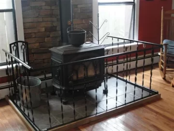

I had the same issue. However, I was closer to 2" short. At one point, I purchased some Rutland castable refractory material to replace a piece on my old dutchwest stove. I still had that laying around so I used a roll of duct tape--sealed off one end, lubed it up with some grease, mixed up the refractory material and poured it inside the duct tape roll to my desired height. After it set up, I popped it out, painted it black and repeated the process 3 other times--once for each leg of the stove. Yeah, I built hockey pucks. Not a good pic, but you get the idea

That is excellent. I just got back from home despot and they didn't really have anything to fit the bill. I may actually do that since it's hardly noticeable.
I too need a rail around my stove to keep my kid from touching it - and that's a nice rail. Where did you get it?
