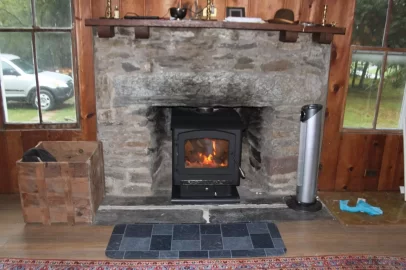

Just completed the install of a new Englander 30 NC and have no clue how to use it. We are coming from a Woodstock Catalytic Fireview so its a completely different ballgame.
I know the part about open the damper all the way getting coals going, loading it full front to back. But when and how much do you damper down?
Thanks,
Bridgette

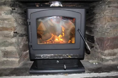

It looks like your second picture you should be able to close it so the tip of the spring is flush with the lip on the ash catcher. It's a fine line between shut down and shut off with that damper. I've read that on other posts as well. But i do love the stove now that i learned how to run it.
