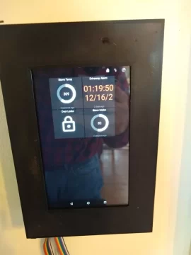

I am thinking to get the best information, you need to attach a temp sensor to the air intake, then a Thermocoupler in the combustion chamber to get the best data. If you have OAK should also have a room temp sensor.
Mine is currently set up with a combustion and air intake sensor for future data acquisitions. Still not done with everything, it is a good winter project.
