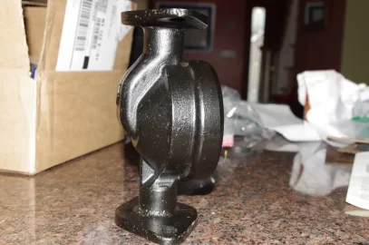

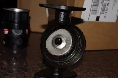

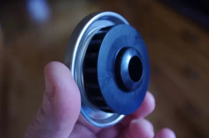

Ordered a Couple Varios
velvetfoot
Dec 5, 2005
10,190
Sand Lake, NY
They look cool.
Have to re-orient the flanges though.
velvetfoot
Dec 5, 2005
10,190
Sand Lake, NY

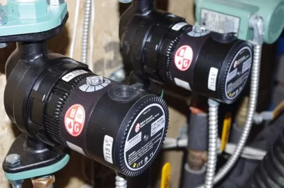

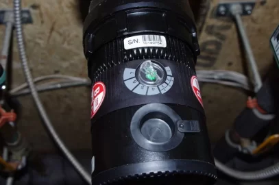

Now I have to figure out how to dial them in. I imagine pump curves and estimated head loss will come into play. Maybe delta T on supply and return (I put in an Azel gauge.)

Why did you go with these pumps vs. a Grundfos Alpha?
velvetfoot
Dec 5, 2005
10,190
Sand Lake, NY
The loads are constant, yet it should be nice to have stepless, but manual, control. There is also an Auto version.

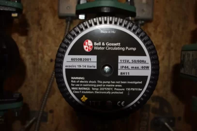

Its a great pump . I think its rated just a bit higher in GPM than the alpha pump . My eco I have running as my main pump , it replaced a B&G NRF 36 when I changed out my termovar for a danfoss valve . The savings in electricity will pay for the pump and the danfoss valve and I dont idle anymore .

webie, did you get the Auto or Vario? i was thinking of putting an Auto on the boiler so that it can react to changing zone loads.
webie
Feb 21, 2009
651
Wisconsin
I got the vario which is my main boiler pump and runs when I am burning . The way my system is set up it runs when the boiler is above 165 and heats my storage unless there is a heat demand then some heat is diverted through my zones because of weighted gate valves . I was trying to reduce the pump speed when running the boiler and thought I had it set running on 5 but I got into a little better wood and out ran the pump at that speed so what seems to be the best is wide open and let the danfoss valve take care of the mix . I am very happy with the pump . It truelly is only useing 60 watts running wide open . I plugged it into a killowatt and checked it . I am happy to say my last months electric bill was down about 10 bucks .
