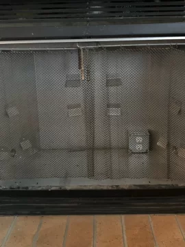

Is this the correct placement for the electrical box for our insert. The company installing just said lower right corner, but this seems big and intrusive. Attached picture

That may not be permitted. What is the make and model of the ZC fireplace?
What is the make and model of the Zero Clearance fireplace it is going into?
We have no idea, it was just a standard fireplace. No idea if it’s ever been used, we had the outlet put in by an electrician per the instructions of the company we are buying the stove from (they’re installing). But the only instructions were to put it in the back right corner.
That doesn't look like a ZC that can accommodate an insert. Are there combustibles behind it?
Many ZC fireplaces expressly prohibit the installation of an insert. All do not permit modification of the fireplace except for removing the doors and damper, that's why I ask. There should be a manufacture's tag somewhere. Typically it is in the doorframe.
Behind it is the outside wall/chimney. The company installing has already come to measure, but the fire brick was still on it. I just took it off to have the electrical put in.
Nothing in the door frame, nor anywhere in the unit.
It looks like a cheap contractor grade ZC fireplace and needs to have documentation that an insert is permitted to be installed. Without any documentation how does one know if the fireplace can support the insert and offer safe protection from the wood framing surrounding it?
What you pulled out was panels that mount to the interior sheet metal shown. That looks like a builder's grade ZC, and it does not look like it is made to hold an insert. Make sure the installer knows what they are doing. Does not look like a compliant ZC to me, but I am basing on what I can see.

Very few zero clearance fireplaces allow inserts to be placed in them. If yours does not by code you can't do it. Also an inserts fan plug needs to be accessible placing it inside the fireplace is against code.
Now because you are having it installed by a pro and they are presumably insured all liability would fall on them. But if anything did happen it would seriously complicate things. And do you really want a company that is ok with violating multiple codes working in your house?

But what we are telling you is they may very well be misleading you about what you can do just so they can make a sale. Your fireplace has to have an ID plate somewhere. If it doesn't it is no longer ul listed and absolutely cannot have an insert installed in it
Found it! Majestic RC36.
There is your manual. It clearly says you can't use any parts or components not manufactured by majestic and approved for use with that system by majestic

Yes I am sure they have but in doing so they violated code and opened themselves up to massive liability. Read the manual for your fireplace that I provided. No additional research needed.
