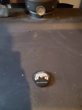

I'm running an Ashley 3200 (secondary air.) STT is often ~700+ if I'm burning all the smoke and I've reloaded recently. (I jump outside a few times and check if it's translucent.) Just a second ago I loaded up and I'm 800+ (see picture) with front air-slides fully closed.What stove do you have? I don't think I ever heard of anyone hitting near 1K if you mean stovetop.

I've attached a picture in case I'm measuring wrong. I still need to get a few gadgets for better measurement/etc.
I should say, I don't intend for it to get that hot and try to make sure that it doesn't. I mostly am bringing it up because the OP is worried about 700 busting his stove.1000º on a stovetop is overfiring the stove, regardless of the stove tech. It's ok for the catalyst to be that hot, but not the stove top. In low light, that area would be glowing a dull red.
700º STT on a soapstone stove is about the limit. Hearthstone wants owners to keep their stoves no higher than 600º. A steel stove can go higher, but 800º is pushing it.I should say, I don't intend for it to get that hot and try to make sure that it doesn't. I mostly am bringing it up because the OP is worried about 700 busting his stove.
