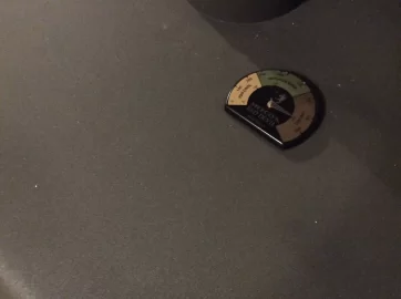

On my old XTD I would place a magnetic on the top in the middle, right in front of the exhaust so the air from the blower would not be hitting it. If taking temps from the IR I would hit the same spot, an overfire for me was anything past 800.

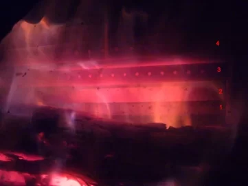

I have not posted many details. Back when I did the mods, it was sort of verboten to speak of modifying stoves, so I didn't do any documentation or posts. I won't run this thread off topic with the discussion now. Though I have posted a few threads ...glowing orange secondary tubes and one nightly loading going to 880F stovetop temp. (I've since fixed some air leaks at the ash pan and now keep to the 600F range unless I really need the heat!)
https://www.hearth.com/talk/threads/burnin-orange-tonight.106714/

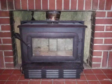

I feel I was pushing over fire last night. I normally burn fir but I threw in some pine last night as I'm trying to get my woodshed cleared right out. Well that combined with high winds led to some very high flue and stove top temps.
This is my stove top temps in the pic. Which I think are ok for my stove but I don't normally like to run over seven hundred. I read 660 single wall stovepipe temp about 12"s up from the stove collar before I smelled the smell of running hot and shut the air right down. Things slowly came down but that load ran pretty hot the whole time.
