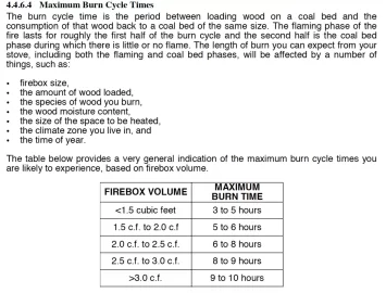

I was just looking at the surprisingly informative Century S244 manual when I came across this section on burn times:
[Hearth.com] Overnight burn?
Reactions: pen
There is no official or legal definition of burn time so some marketing has a field day with these numbers. With the right wood you probably can have a fire in a 1.6 cu ft box that will still have some hot coals the next morning during milder weather. That is what some will call the burn time. What you want is rarely reported - the period of meaningful heat, which for a 1.6 cu ft stove is more in the 4-5hr range.
