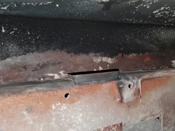

It looks like my baffle gasket has disintegrated. So I guess this helps with the uncontrolled burn by not allowing air into the firebox. Right?

Pacific Energy does not need to use a super large door gasket because of the knife edge door that closes tightly against the door gasket, most competitive stoves do not have that. You may very well have a loose/worn door handle or the latch itself needs to be hammered in a wee bit.
You have the correct place for the air tube/baffle gasket placement, that gasket in my experience never last more than 2 years depending on amount of usage. Without the secondary air tube gasket it seems to send extra air into the firebox causing higher primary temperatures and less secondary's, that has been my experience anyways with my PE.

I usually replace the baffle gasket annually on my T5. I drop the baffle to run a soot eater through the pipe every year, and usually the baffle gasket is shot at that point or damaged when removing the baffle. On the few times I have removed the baffle and the gasket has looked passable, I'll just leave it as is, but overall it's a pretty lame gasket.

Yep, unfortunately that baffle gasket rarely last much more than a burning season, it does need to be replaced yearly with its annual cleaning / sweep.

Yeah even if you can remove the baffle without roughing up that gasket usually they are just pretty well shot after 1 season. Some day I'll get it together and make the home made ones that a couple people on here have posted about which will last far longer.
