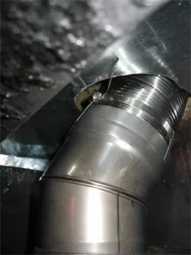

Done every day by installers. 30 degree stainless steel elbow banded to the liner and the installed INSIDE the flue collar of the stove. Here is mine. Costs about 40 bucks. Don't even think about using a steel adjustable and having it burn out in two to three years.

BB, wouldn't you agree that a stainless adjustable would be ok? I plan to replace mild steel adjustable elbow with a stainless one at the end of the season.
thanks BB. 30 degree elbow replaces the adapter. I will try and find one tomorrow. Hopefully i will be burning by the weekend!
Notice he has the one with the flex liner clamp built into the elbow.
Also notice how it flanges out to accept the liner into the elbow.
Buy the right one the first time and save yourself some aggravation.
I did notice that. Hoping one of the shops nearby has that in stock. I am not sure I could handle having to wait to order something online.
