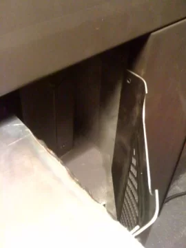

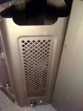

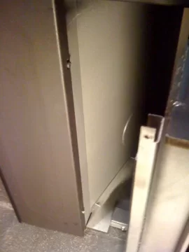

OK, the insert is in and now I am attaching the surround and side panels and I would like to double check something. When I put the right side panel on, I seem to be putting a decent amount of force on the motor. I don't know that I remember that when I took the side panels off? Also, the side panels just attach to the stove front via 2 screws and not to the surround at all, correct? There are holes on both side of the side panels but they only line up with the front of the stove, not with the surround.
Am I doing something wrong here or am I just being to critical. Also, there was one screw without any coating, is that a ground screw for connecting the motor controls?

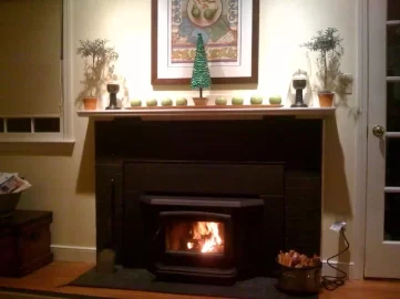

First burn tonight and so far so good. Thanks to everyone who helped a noob get through this install.
-Tucker
  • [Hearth.com] Pacific insert install, so close, please help
Congrats !!!!
You are going to love this insert !!!
