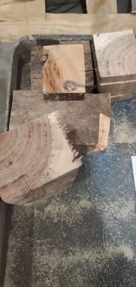

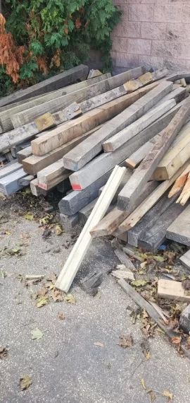

I work at a fab shop and see tons of hardwood 4x4 boards get taken to the shredder and hard wood pallets. Pluse a ton of pine 2x4. Could these be cut up and used as kindling . Would the pine 2x4s be ok

Maybe I will just try these out. I would only use the hard wood and these a ton. I would cut up and use only for kindling . I think there just rough cut 4x4s we get them as kribing for big loads of pipe. Just didn't know if it was safe

Edit - PS - those 4x4's might not be too bad. Definitely avoid any treated ones. My 'rant' above is mainly for pallets!
Hard to say. There are a couple in that pile that look a little 'green' to me. I don't know that I've specifically seen a treated "rough cut 4x4" - but I have noticed quite a few treated 'odds and ends' laying around the lumber yard, shipping receiving docks, etc. I think some of this is used for spacing / cribbing when treating dimensional lumber, so these chunks become treated, too.
