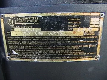

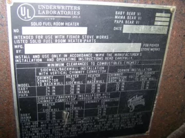

These stoves pioneered the safety testing and insurance regulations, but were tested by different agencies not recognized nationally until testing practices became standardized after this stove was built. The labeled appliances will be made after 1980 with shields on bottom and rear with the required label on the rear shield. If your area includes certification for smoke particulate, they will not have that label. Unfortunately they treat anything without a label as a homemade untested item that is unknown.
You would have to ask the WETT certified inspector if the labels below are recognized as approved safety testing; They may require Canadian testing as well. Provinces and local criteria vary in Canada.
[Hearth.com] Papa Bear wood stove Paton  D237798 [Hearth.com] Papa Bear wood stove Paton  D237798 VI Models

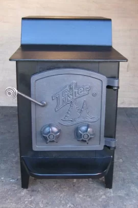

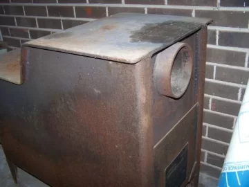

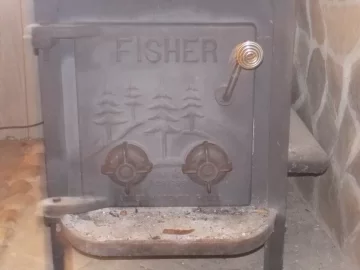

Those newer labeled Papa Bears look like this;
