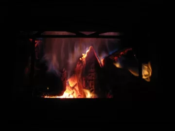

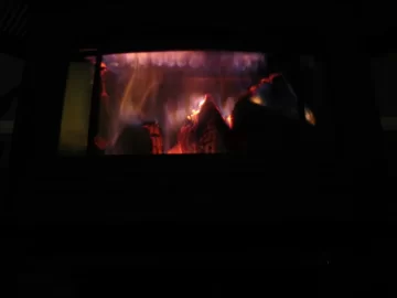

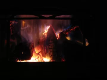

Finally loaded it just a little over half full much more and I think it would run us out of the place. Flue temps seemed a little high 750. It jumped from 500 to 750 really quick and even with the primary all the way down for a good 30 minutes it is still hanging around that temp (stove top is 700) so I'm not sure if I didn't start shutting it down soon enough. Does the fan help lower the flue temp much on this stove? I have never had a flue temperature probe in the chimney and I'm used to seeing the stick on magnetic thermometer on the outside of my single wall pipe hover around 300 to 400 (anyone know what that equates to for an internal temp). Another thing I noticed is with more of a load and longer pieces of wood the load really wants to burn at the front of the firebox during the beginning stages of the burn which causes the flames to lick up towards the flue exit and be pulled over the top of the baffle.

Nice shots. Is there some locust or Osage Orange in there? If the stove was hot on the refill you could be seeing some EBT action there, burning off the excess outgassing.
How are the room temps? Think you'll make it through next winter? :)
Very nice pics Cert! Gotta say those secondary burns are rather mesmerizing to watch.. Are there cat stoves that give a similar fire show? Need to redo my hearth before I can consider another stove and it could be tricky as my hearth abuts an irregular shaped chimney.. Not sure how to approach this yet but it sure would be much easier if it had flat stone instead of field stone (this chimney has a cultured stone on it).. I think you're gonna like that stove and forget you ever had a Dutchwest!

The stove was fairly warm and had about an inch of good hot coals on the bottom at the reload time. I checked the EBT about 40 minutes into the burn and it was about a third of the way open while the temps were up in the flue (not real sure what to think about that). No Osage Orange, I don't even think I have had the pleasure of cutting any of that wood. The only thing I had in there was 4 year old red oak and one chunk of white pine. When I am loading on a bed fairly good bed of coals and the wood catches easily should I shut the air back almost immediately?
Room temp was getting up there around 77 I think. Let me tell you what that stove will put off serious heat I have a really hard time imagining stuffing that fire box full and letting it go to town. I will say that inspite of it seeming like it was going to burn the whole load down in an hour it easily went 9 hours without a problem and I think it could have went 11 without a problem. I loaded it up at 9:30pm went to bed at 12:00am and it seemed like it had burnt a substantial amount flue temps were at 620 and stove top was 725. I got up at 6:30 and there were still big glowing chunks on the side of the stove and the whole bottom of the stove had orange glowing coals. Flue temps this morning were 200 and the stove top was still almost 300. It took about 5 minutes to have the wood lit off and 15 minutes before I shut it down and walked away. This morning I brought the air down in more stages and more quickly. It was a four split fire and the stove top settled in at 600 with the flue probe running about 500 which seemed a little more reasonable to me.

It depends on the wood, the wood species, dryness and size. If the pine wasn't in there I would expect to have it open for maybe a minute before closing it down in steps, maybe 50% for a few minutes, then all the way. I would not mix in pine unless the coal bed has really died down. Save the pine for shoulder season burning and fire starting. And it depends on how hot the coal bed is. I like to let the coals die down a bit more before reloading with the stovetop at about 300F.
You're burning hardwood, so you will see different burn times, coals and heat than I do. It sounds like the beginning of a beautiful friendship. Enjoy!
