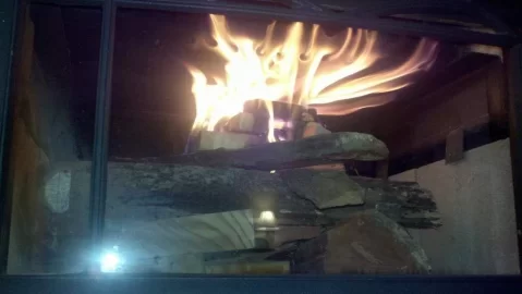

So I had to dig this thread back up......
So after a year of being on this forum I finally decided to start a top down fire last night and I gotta say I was really happy with the results. Don't knock me to hard for how crappy I stack/throw the wood in stove but hey I was skeptical how it was gonna work and next time I will set it up a little bit nicer. You can see in the photo that I stacked the wood pretty high so the flame off of the fire starter was immediately licking against the baffle in the top of the stove. Here is where I got pretty stoked (I know it's a bad pun) in under 5 minutes you could see secondaries coming out of the baffles. The secondaries continued for the rest of the start up of the stove and I have to say I am still floored. I went out and checked the chimney and there was only a trace amount of smoke coming out of it within minutes of lighting the fire starter. Thanks for turning me on to this fire starting method guys, I'm definitely sold on the top down method now!

I agree Jesse it works very well with my Alderlea too.. I have a question, How long do you wait to move the air lever from full air to another position? Basically how do you determine what position to place the air lever and how long should I wait to reduce the air?

Eyeball experience. If you turn it down to early and too much, the fire smolders and you will coat your glass.
Really variable with stove temp, ie cold start vs reload.

Honestly with this stove I depend on the flue thermometer for judging when I start to turn the air down. I have been letting it go for about around 15 minutes (give or take a few depending on the conditions) and when I see the probe thermo hitting that 400°F mark I start to shut it down. I honestly have only been shutting it down 2-3 stages and it seems to be doing fine and the secondaries stay going strong. Sometimes I go straight from full open to half and then to closed and other times I have done it in 1 maybe two extra steps. So far I have been loving this stove and I can't wait to try it out in the really cold weather as I have no doubt it's not gonna struggle.
