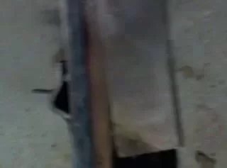

Ok we just took baffle out and it looks like it is not sealed is it suppose to be? is it suppose to be all one thickness front to back? this is not. metal is pulled away.
Vacuum out the secondary feed tube thoroughly. You may have to tape a section of small diameter hose to your shop vac to do this.
I am not sure I understand the second question. The baffle box should be a closed unit, top and bottom. Can you post a picture of what you are seeing?
Sorry took with my Cell Phone. Can you see the way the metal isn't attached and you can see the insulation. Can anyone tell me if this is normal? we put it back in the stove but if it needs to be replaced I would like to do it while it is warm out. Thanks for any help

Well I hope so, I can not make out the picture enough to tell, maybe this bump will get some one to answer.

I have to agree, the picture doesn't show much. I'm not sure what the issue is. Was the secondary tube plugged?
