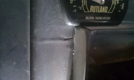

Look what I just found!
Also looks like there is a line all the way across on both sides.. looks like that's where it was put together
Looks like I will have to put a claim in to...
There goes my dream of a t6 in the basement:(
I don't see cracks inside but a few places where it seems a tiny bit of the weld is gone ?

I am sorry to hear that, Iceman. What are the particulars on your Summit (eg. year of manufacture, amount of wood burned per year, etc.)?
Let us know how your claim goes too.

Well,
I burn 3-4 cords a year ... Not sure of the birthday but it was installed in 07
I have seen this thing hit 800+ and CALLED PE only to be told "it was built for that , don't worry, if it goes to 900 for extended periods of time then start checking your gaskets'

Iceman, have a good look at the welds in the upper corners of the primay air channels. You may have to brush away some grit. I suspect the crack on the face (mine has one also), is a symptom of the internal welds letting go. From the picture, it looks as though yours has even buckled a bit. Good luck.

Where abouts is your baffle coming apart? Can you take and post a photo of it?

Iceman,
I have looked at that pic and are you sure that's a crack? Looks more like a seam to me.. I wouldn't think the weld would sag as it is steel not solder or bronze etc.. Seems everyone is over worried about the PE stoves .. I wrote PE and also The chimneysweep online and recieved answers to my questions and positive remarks from the sweep and PE (Cory) backing their products.. According to the Chimney Sweep they have no problems with cracks and though they did not sell me the stove explained all questions and concerns.. I was impressed that The Chimney Sweep took the time to talk to me even though I bought my stove at a local dealer.. Good Luck!!

Yes ray it is a seam but that's where the crack is starting... The same thing on the other side at the seam..
I am also experiencing some stress on . The inside welds... It seems to me as the crack will get wider causing the seam to possibly separate.. I am not sure as I don't know how it was put together

Anybody ever notice that these busted stoves are inserts. Folks quit running these things at temps measured on the front of it based on what PE and everybody else tells you about the temps on the stove top of a freestanding stove. Two years ago I reported here about testing temps on my old insert. The front of the thing is 150 - 200 degrees cooler than the top plate. I did the measurements again last year with the 30-NC and the spread is larger. Because the air wash in the front to keep the glass clean cools the front of the stove.
So if PE tells you that running a Summit at 900 every once in a while won't bust it, they ain't talking about 900 on a mag thermo stuck on the front of it.

That is a good point BB. Last year , I used an IR as well as 2 stove top therm on the front and never got the same temp from any of the 3 at the same time .. my IR was always the lowest with the biggest diff of 125 degrees..
Most of the time the 2 therm were off from each other 50-75 degrees .. but that would be where the most stress is as cool air is coming in right there but hot air is also.going up the chimney right under it ... So I can imagine that may have something to do with it

I did notice that and had wondered if it had something to do with the stoves running hotter or having a greater temperature differenrtial between the front of the stove and the rest of the stove due to it sitting back inside the fireplace. I would love to know if their engineering department has run any thermal models on the inserts.

Hi BB,
I don't know if people are running into the 900s, but mine was dipping into the 800s. After burning 24/7 during the winter months, the stove would spike after putting a full load for an overnight burn, after the stove dropped to 300. The concern is that this was neither intentional nor could it be controlled (since the air control was fully shut down). I am not sure if everyone else is experiencing the same issue. But, how does one control an insert's burn, after the air control is fully closed?
The other question is if the front is cooler vs the back, why would the cracks appear in the front of the stove (where theoretically the integrity of the steel should be stronger because it is cooler)? I am not trying to debate the use of the magnetic thermometers, but I think they are used more for curiosity/characterization vs operation gospel.
What would be good to know are the details of how everyone is running their PE stove (eg. how many cords of wood burned, type of wood, length & diameter of flue, do they feel it is running too hot, etc.). From reviewing the threads, there might be some variation in use (eg. Nic 36 had a cracked Vista Classic that he said only burned one cord a year vs my Pacific burning 5 cords a year).
From what I have heard, there has been a design change, since the 2006-2006 PE were manufactured. Apparently, they no longer weld the stoves at the places where the internal welds let go (primary air/airwash). That might be in recognition that the design was in part responsible for facilitating cracking.
