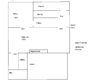

Trying to decide between the PE pacific and the Jotul 550. We live in a 2800ft colonial in RI. Not uncommon to see 0-10*F in Dec-Jan. We need to heat 900 downstairs and 1400 up, as there is a closed off formal LR/ DR on the downstairs that is zoned off and we can keep at 60*. Not a wide open floor plan, but well insulated with new windows and doors and 8' ceilings. Installation with full SS liner runs about $3100 for the PE and $3500 for the Jotul. The chimney runs through the attached garage (is this interior or exterior?). The room that the insert will be installed is our family room on the first floor, where we watch TV, so the room needs to be inhabitable. Other factors are that I am a rookie burner, so ease of use is a factor. My goal is to significantly reduce my oil bill, not completely eliminate it - although that would be nice. The Jotul is a beautiful piece but the PE is not bad looking either. However the end goal is the right stove for me and my house. The fireplace is big enough to hold either. Reports on this site are superb for both.

If you can post a simple picture of the floorplan that would help. We'll need to understand how the rooms are placed and whether there is a chance for good heat circulation. What is the size of the family room? Is there a door or a large opening connecting it to the other rooms?

This is not what I would call an open floor plan. The room is about 15X25. There are two regular size doorways across from the fireplace. One to the kitchen, the other to a foyer that goes up to the bedrooms. We spend the majority of our free time in the family room and kitchen. I am fearful of having to burn the Summit too low when we are in the room, thereby creating creasote and dirty glass, although it would be loaded up and burned hot every "overnight". Also, the PE pacific and Jotul 550 match up pretty close in terms of BTU (app 65-70,000), firebox around 2.0 cf. Jotul is much heavier.
Agreed you will probably not be heating the whole house given that arrangement. By putting a fan low on the floor in the doorway, blowing into the family room from the kitchen, you may be able to circulate some heat there.

What's the size of the family room? What's the size of the doorway connecting it to the rest of the house?
Here is a crude depiction of the layout.

That helps. Are the FR doors all standard 3 ft?
This is not as bad a some layouts and the family room is large. Also the FR is central which helps. A bigger stove may work after all with some fan assistance to get the heat circulating into the other spaces. It won't be ideal, but you don't need to make massive fires all the time. Do compare the Summit if you are looking at the C550. It's a well behaved stove. You can run smaller fires in it and still get good secondary burns.
Thanks. I am pretty confident about heating the kitchen and family room and getting some residual upstairs on normal winter nights. As I said earlier the house is tight and has relatively low ceilings (8") throughout. PE is well represented on this site and it is a nice stove.
