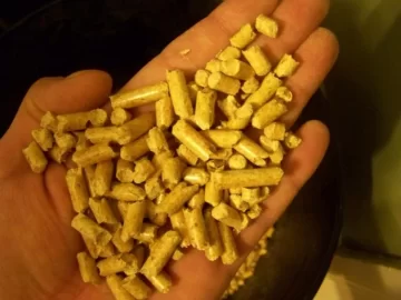

So one of my questions is what should the consistency of a bag of pellets normally look like? Meaning my pellets (at least the first two bags) are pretty fragmented a lot of small pieces. I attached the picture to see if someone could give me and answer if this is the norm, or not.
I think the small pieces are causing issues when the auger turns and nothing falls in the pot (which I know is normal?) Then it turns and this time only small fragments fall in, or a lot falls in and it sounds like I hit the jackpot on the slots :-) I think this is causing some burn issues, fire going out, trouble dialing in the damper settings and pellets seem to burn unevenly. Pellets will pile up on either the left or right side while the opposite side burns, then the side burning will slowly move across to the other side then I have a full on blaze for 5 minutes then it dies down and starts a new with the pellets piling up on one side.

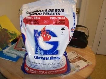

look up the word, GRANULES,and you will find the answer
oh my gosh i just upped my posts
Thanks for the tip, but search for GRANULES doesn't answer my questions. just talks about different pellets.
Don't have the same stove but here's my take.
Unless the fire goes out completely and you have to restart
I wouldn't be too worried. My stove behaves in a similar
fashion any time I used pellets that are cut short like those LG's.
I've had a couple tons of those and all of the pellets seemed
to be shorter than the brands I've been burning the past few years.
Definitely have had to adjust the air intake at times when changing
brands.
Oh got yeah sorry about that, just wanted to know what is the norm on the big to little pieces, and zeta answered that.
