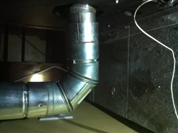

Anchors are better and will last longer. IMO the support in the pic below is bolted right to the studs in the wall. This will not only hold up the pipe but also stand the test of time when the stove is pulled out for servicing. The wall plate can be painted the same color as the wall to blend in better too.

I hate to say it but you need to redo the exhaust of this stove from the start. Your smoke is probably at the appliance adapter, the first peice of pipe on the stove. The best way to find where the smoke is coming from is with the lights off and use a flashlight.

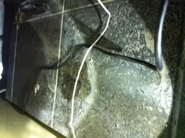

While trying to find the smoke I noticed this wet spot. Can anyone tell me what it is?

That first peice is crooked as all heck and maybe not on the entire way.
Yep boosted3g you are correct and that spot could be just about anything. The reason I wanted to know what was above it is sometimes motors will leak lubricant (that is what happened to my first combustion blower when new) the spot was oil in my case.
It does feel like oil.
There is supposed to be even gap there and the adapter is supposed to be as far back towards the stove as it can go.
Oh and I don't see any sealant and I do see signs of exhaust leakage and there doesn't appear to be any screws and there must be (3 of them to be precise).
If you look close at the last pic the first elbow connected to the riser does not appear to be on completely.

Bottom line is that the install is a disaster and it needs to be re-done by a qualified person....not a general contractor who used gas pipe to start with.
Mommyof4, you need to stop using the stove right now, if you are concerned about carbon monoxide poisoning at all. That exhaust is so bad it needs to be taken apart and re-installed by someone qualified.
