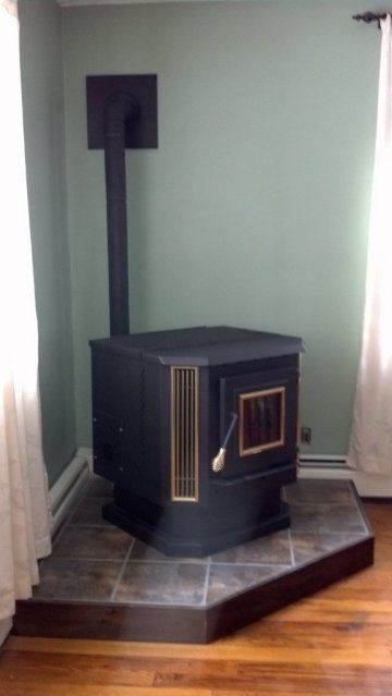

Here is a picture with a clean out "T" coming off the back of the stove. Also, I have pretty much the same set up as you have shown and I have not pipe support and find no need for one. Good luck with the contractors.

Here is a picture with a clean out "T" coming off the back of the stove. Also, I have pretty much the same set up as you have shown.....
Yep, your install was so nice & clean, I had already given her the link to your stove thread back on post #35......wanted her to see what a good install looked like. ;)

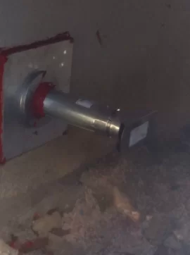

This is the exterior of the house.
WTF!!!
No T on the inside, T backwards on the outside against the flow, seam buried inside the wall, venting under a deck, wall strap not needed but not anchored...this install is a mess and shameful and whoever did it should be reported and your builder better pick up the entire cost of NEW venting and the cost to reinstall all correctly. Use places like Angies List and Google Places to tell the facts and keep these clowns away from burning the next house down...seriously.
Reactions: Brokenwing
Ok well good luck, and I hope your contractor hires someone that knows what there doing. At this point I would of demanded a qualifed installer from a pellet stove dealer.
WTF!!!

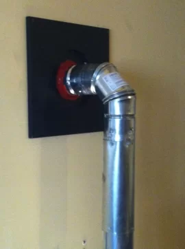

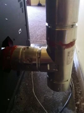

OK...I think the new guys got it right this time. Screws placed on the adapter and siliconed. The tee is placed inside and all the parts are straight. Also, no joints in the wall.

That's better, but I don't think it is exactly as it should be.
I don't have the instructions for that vent system at hand, it would pay to look at the instructions for installing the vent pipe through the thimble.
I don't believe there should be any sealant inside the house where the vent goes through the thimble only the outside has the sealant around the vent where it passes through the thimble.
Perhaps Scott or someone who uses that particular venting will chime in.

Is it a hazard issue or just asthetics issue?
Finally... Really don't think it would matter, others should be along for input....

By the book with an exhaust system, always by the book.
I don't have the instructions for that venting but with mine you don't put anything at all in the annulus on the inside of the house.
At least it is done, those guys need some lessons on sealent use. They should of used Black RTV high heat silicone, it would of looked a 100 percent better. Hey at least the pipe is installed correct now.
Would I be able to put the black over the red?
Yes, but it might look weird. If it were me, I'd just use a utility knife and cut most of the interior red stuff off....doesn't have to be 100 gone, just most. Then go over it w/ the black Hi Temp. Use a wet finger to smooth it out.
I'd just mask everthing off and give it a quick spray with black stove paint.(the entire interior venting).
