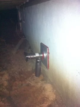

What's on the outside of the house?
Can you screw through the pipes without any issues? There doesn't seem to be any premade screw holes in these pipes.
This is the exterior of the house.

Cannot for the life of me figure out what that piece of pipe on the outside going down towards the ground is for.......did they put the cleanout T on the outside???????
If so, that's what's wrong here...that T is supposed to be inside connected to the appliance adapter, and the pipe outside is just supposed to be just a straight piece w/ the cap on it.

The only thing that should on the outside is the thimble plate, a piece of straight pipe sticking through, and the cap....that's it. It looks like they used the cleanout T......soooo wrong.
Are these installers from a stove shop?????? If so, sorry to say they have NO idea what they're doing.
If thats a tee it needs to go on the back on the appliance adapter. Most times the elbows and tee's share the same throat length so it "should" be a direct swap for the lower elbow without having to mess with the thimble in the wall. Without the tee on the outside you may need a short length of straight pipe to get it further off the house and make sure the joint is not inside the wall. It looks to be very close as it sits right now.
That looks like a ground support. I have never seen a worst install like that. I would have code enforcement over there and demand my money back. You need to have the install manual handy for them. that is a fly by night install. Is that install under a deck??
That looks like a terrible install, under the deck does not bother me so much. But the clean out T needs to be inside the house.
Wow, that is not a very good looking install. The installers either need to come back to redo it or you need to demand your money back and get a real professional to do the job right! I've never seen a clean out tee on the outside of a house before. That's just odd. And what's up with the bracket inside? I don't think that's necessary. Was this done by installers from a stove shop? Or just some guys doing it on the side?
