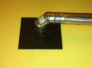

I'd just mask everthing off and give it a quick spray with black stove paint.(the entire interior venting).
Of course using proper ventilation.
I sprayed it down with the high temp spray and it looks so much better!
