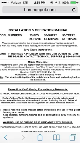

Is that an Englander stove? The number seems to come up as a part number for the control board? There should be a label on the back of the stove or the underside of the hopper lid that will identify the stove. If you can't find this, post a picture and forum members should be able to identify.

We have one of these..there isn't anything in the manual if this happens.

I attached a picture below of one of the stoves I have. The person below me suggested a wire hanger to see if its jammed. What do you think?

Xkaylasamantha, how did you make out? Sounds like you have the manual - Chrisnow86 is correct in that you can open the hopper lid as long as you activate the hopper lid safety switch. Auger will not turn if the lid switch is not engaged or disconnected - a safety feature.
These stoves are the two auger system as mentioned by Chrisnow86 and the manual... page 26 mentions potential auger problems that folks here will help you with troubleshooting (broken link removed to http://www.heatredefined.com/assets/images/general/25-PDVC.pdf) Wilbur's advise was based on a one top feed auger system since we didn't know what pellet stove you had...
