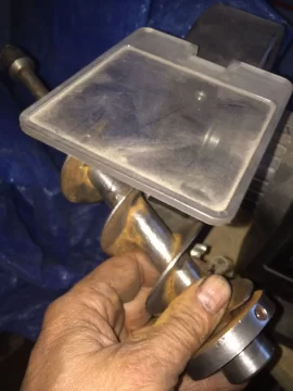

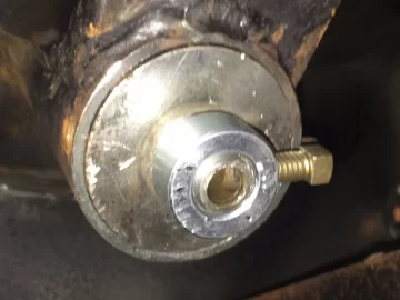

Now is a good time to pull your auger and check those bearings! In this case I found the worst scanky rusted stick auger. So you may use some of the steps to fix your own here.
This Pelpro HHPP2BD is so rusted because it had damp pellets and stored in a basement!
See my last post on getting that rusty auger motor off!!! @#$%#$!!!!
https://www.hearth.com/talk/threads...-and-rather-rusty-auger-motor-removal.144489/

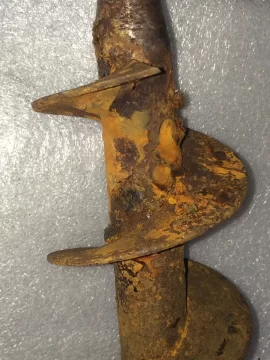

Has anyone seen such a rusty auger like this?

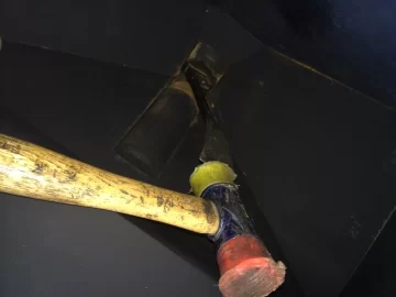

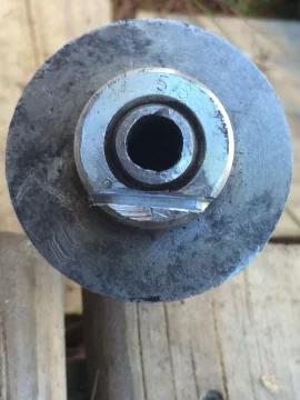

Pic 1 - After removing the auger motor and bolts, just tap the auger to remove auger and plate biscuit.

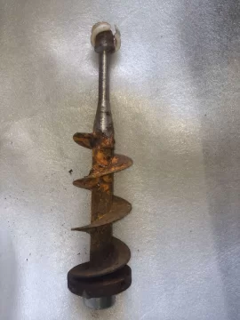

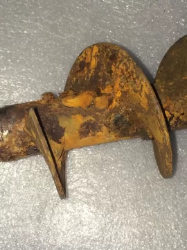

Pic 2 - 5 - Wow. this auger is rusted!

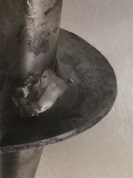

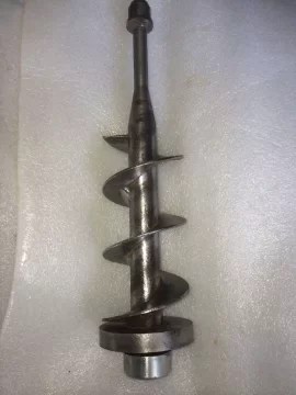

Pic 6 - Auger on the bench wire wheel
Pic 7 - Drill wire wheel gets in tight spots on auger
Pic 8 - 9 - Auger is all clean now

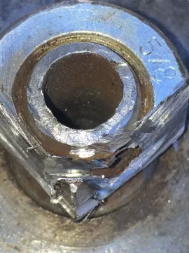

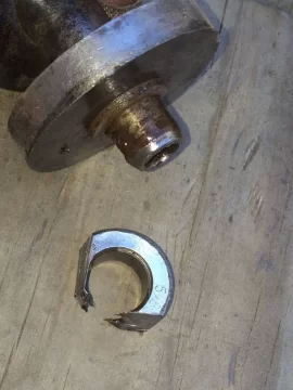

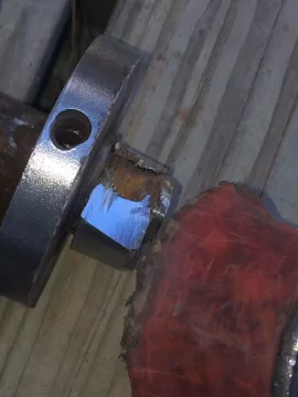

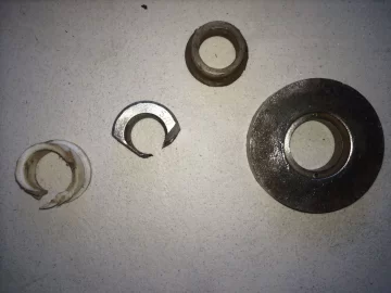

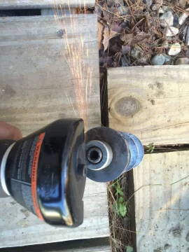

Hello
Oh no, the auger collar set screw was completely removed, but the collar is frozen on to the auger! Cannot change the scanky bottom bearing until it is removed!
PB Blaster and some tugging and banging did not help! I must pull out the air cutter!
Pic 10 - 11 First cut to remove frozen auger collar
Pic 12 - Third cut on auger collar
Pic 13 - Auger collar finally starting to come loose. More PB Blaser
Pic 14 - Got it off!

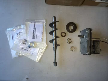

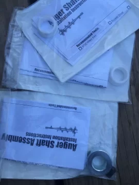

Pic 15 - 2 new bearings and new auger collar
Pic 16 - Ah-Oh Auger Pox
Pic 17 - Grinding down the pox!

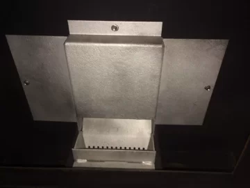

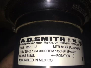

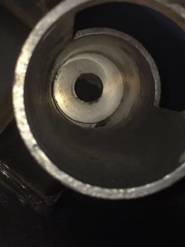

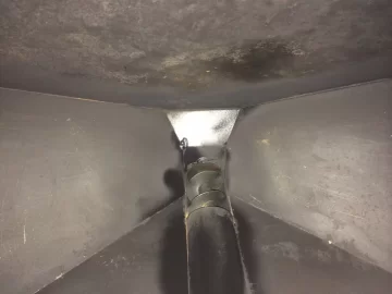

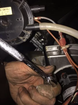

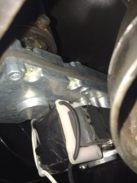

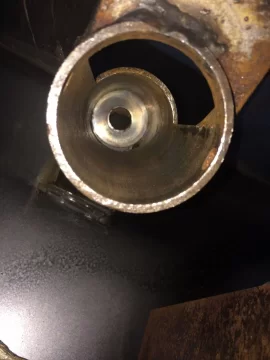

Hello
More pics
Pic 18 - Scanky Bearinngs
Pic 19 - Bearings and motor

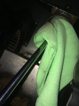

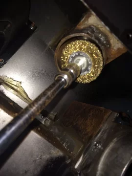

Pic 20 - Clean auger chute with wire wheel and extra long extension on drill driver
Pic 21 - No more rust in auger chute
Pic 22 - Wipe out chute

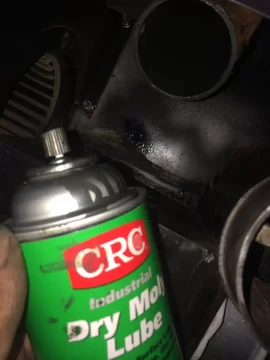

Pic 23 , 25 - Dry Moly auger chute

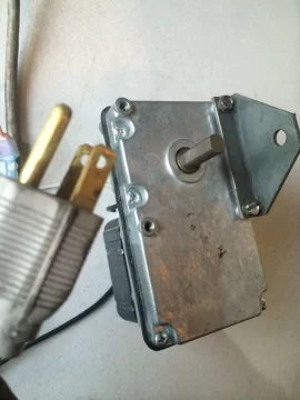

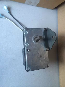

Pic 26 - Transfer old stop bracket to new auger motor

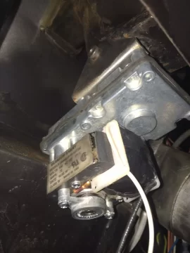

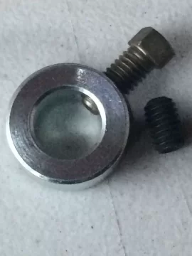

Hello
More Pics

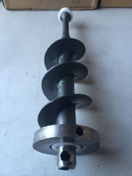

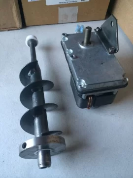

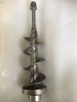

I always like to upgrade the auger collar set screw that takes an Allen wrench to the much nicer set bolt that you can just use a rachet and throw a socket on it. :-)
Pic 27 - Auger with 2 new Nylon bearings
Pic 29 - Auger sprayed with Dry Moly and Auger Motor with bracket ready to go
Pic 30 - Turn auger motor so flat spot is opposite bracket for easy installation
Pic 31 - Upgrade set screw to set bolt
Pic 32 - Auger re-installed with upgraded set bolt
Pic 33 - Tighten down new upgraded set bolt
Pic 34,35 New auger motor installed.
Auger now turns like butter! Better than new with no auger pox. (Sharp pimples of splatter slag from the fins welded to the shaft)

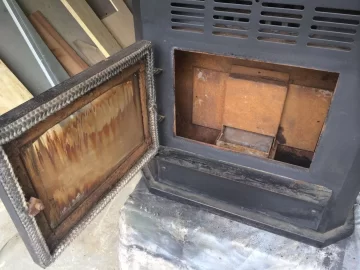

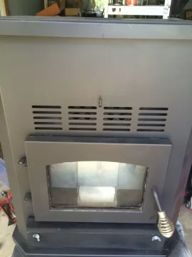

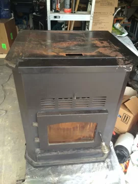

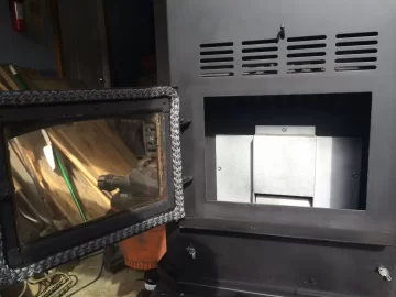

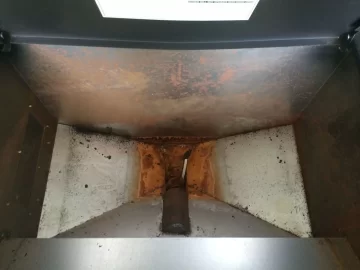

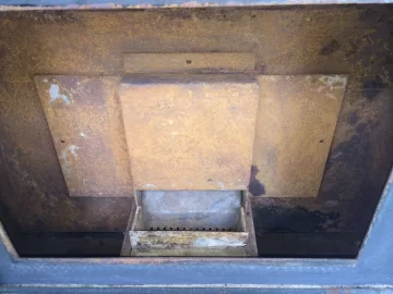

How did it get rusty?
It was in a basement, but some very damp pellets were left in the bottom of the hopper and in the auger chute that turned to mush!
See before and after pics of hopper with rusty auger. See Dry Moly now on polished auger!
Click pics to enlarge:
  • [Hearth.com] Pelpro Sticky and real rusty auger with dirty & torn auger bearings & frozen auger collar - fixed!
Before !!! & Final Pics :)
Click to enlarge

Sand Blasting the fire box and burn pot is a little quicker and it comes out much better. :)

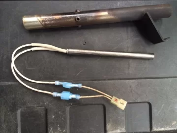

I put a new igniter in it and an upgraded brand new Accutron IV control panel so a T-Stat can be connected.

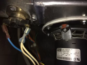

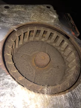

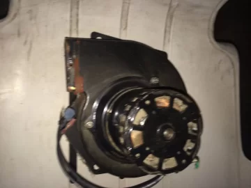

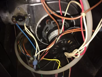

The OEM squirrel cage exhaust blower also died. The squirrel cage collects ash and seems to become more noisy and warbly than the impeller type. Also it is very hard to removee and clean because the venting must also be disconnected. Therefore, I upgraded to the quick change Fasco impeller motor that works well with the Accutron control panel.
See pics and click to enlarge
