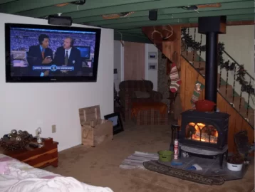

I have a 50" Samsung Plasma mounted on the wall approximately 5 feet from my Jotul F 400 Castine. We're not concerned, I do not think it's a problem. This Plasma is pretty efficient and does not get warm like previous models. I don't think it'll have any ill effects on the television's life span. I think it's a perfect combination....Sitting on the sofa watch HD and a beautiful fire, what else could you want?

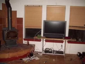

Hmmm- dust is certianly a concern here, especially when dumping hot ash into the bucket.As far as distance is concerned I'm pretty comfortable with what I've cobbled up. I figure if things get too hot I can place a peice of sheetrock at the side of the TV to sheild it from the stove heat...............
  • [Hearth.com] People with Plasma or LCD tv's near wood burner??
Man bro you got enough wires for a concert
A work in progress. The last cabinet/desk I had there was too wide so I had to place the subwoofer in another spot in the room but apparently I'll be able to bring it back in the area of the TV no that this new table is narrower. Like I say- it's a work in progress..............
