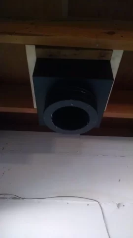

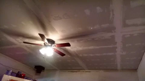

I did the same thing with mine this month. i ripped everything and reframe it, insulated, put some phase change material on top of the insulation for some thermal mass and sheetrocked. the chimney was only 7x11 and did not let me run a insulated liner plus was to much hassle. i move the new install to a corner. I also did the whole ceiling in that room and incorporated more of the phase change material in some areas.
