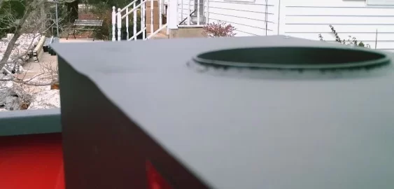

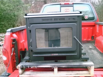

I'm at the new home in the mountains and was planning to do my stove insert installation this weekend while I have the help of some Christmas relatives to help carry the insert into the house. I borrowed a truck and was in and out of the fireplace store in 15 minutes. By the time I was home, Santa (aka the FedEx guy) had dropped off my liner kit and insulation. I also received a "GO" from the insurance company and inspector. I love it when a plan comes together ;-)
While I'm opening the insert box I start wondering if the wood pallet is dry enough to use for a break in burn in the driveway and if I have the tools to fix my chainsaw to cut more wood. The next thing that happens is the classic WTF moment. The "new guy" must have welded my stove together. Pics are below. It looks like he welded the top plate from each end and towards the middle. By the time he welded the middle of the plate the metal expanded into a hump and he continued to weld across it. (BTW: Yes I weld)

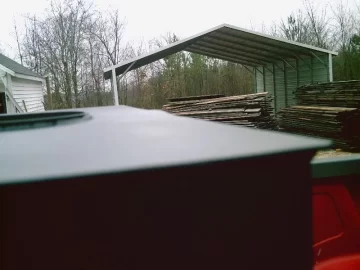

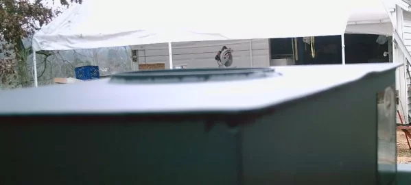

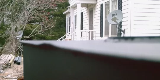

The bottom line is that there's a 3/16" hump in the top plate of the insert because of an improper welding procedure. It's not a structural defect but it will certainly effect the selling price if I was to ever sell the insert. I'm also a little concerned about the quality of the other welds that I can't see. However the welds I can see look like they have adequate penetration although they are slightly ugly.
I have the insert on the bed of a borrowed pickup. I need to get if off the truck or replaced or something. I've talked to the factory over the course of the early afternoon but they didn't call back with a solution before closing for the Christmas holidays. (Did I mention that I had to drive past the factory to buy the stove) Anyway, Lifting the stove off the truck is not a problem but putting it back on the truck after the holidays is going to be difficult due to lack of man power.

My guess is Mike & Corie will work with you to replace the stove. Given that it's the holidays it might take a little longer but I'm sure they'll come up with a fair solution.
This is really an unfortunate time for me to see this because at this point there isn't much I can do. However, I do happen to know that customer service will be open tomorrow morning for approximately 3 hours. They should be there from nine until noon. Please call them as early as possible, and ask for Mike Holton. He will get you all set up and will use his best judgment (in conjunction with the judgment of our customer service manager) to remedy this situation to the absolute best of your ability. If I was going to be at work in the morning, I would give you my direct line, but the development lab will be closed tomorrow.
If you get get in contact with Mike Holton ask for Chris Terrell (The customer service manager) and he will most definitely be able to take care of this.
If the ultimate decision is to give you a replacement unit (this decision is not up to me), rest assured that I will personally be checking every inch of welding and steel on the replacement unit and you will get a unit that is as perfect as I can possibly find.

Golly it is one nasty looking wrinkle. BB on Goose brew is as good an answer as any. :ohh: Goes into my laundry room, plugs in the iron and smooths out the stove wrinkles.
after researching this issue , found that the unit was sold to a local dealer who purchases stoves from us for resale. some units he purchases are "factory seconds" which have some kind of cosmetic blemish on them that while they do not compremise the safety of the unit (anything of that nature would have been destroyed and leaves here only in the scrap bin back to the steel place for recycling) this unit was one of these "seconds" the unit is sold to the dealer at a discount , which is then passed on to the customer. this unit is normally sold at about $1150 retail the one in question was sold for considerably less. the dealer however apparantly did not mention to the customer that this was a "blemish" unit. i have talked to the customer , explaining this , and the boss has contacted the dealer, who agreed to swap the unit out should the customer wish to bring it back. i would emphasize that the location of this bulge is part of the "convection" housing and not the actual firebox itself. and while it is "unsightly" (hence the reason for "blem" status) when installed , this would not be visible as it would be inside the fireplace hidden by the shroud. also , this bulge would not in any way hamper the operation of the unit. the unit would also recieve the same warranty as a unit purchased at regular retail price. i have left this situation in the hands of the customer who does as stated have the option of recieving a replacement from the dealer (who said , he would swap it today if the customer wished to bring it by)
Glad to see it resolved.
Tell you the truth, I would accept a unit like that for my fireplace- assuming I thought that I was getting a good price on it. But, then again, I admittedly would never be given a job in QC.
As you note, it is just the air (convection chamber).

Yes, the defect is in the air chamber so there's no safety issue. Also Mike did assure me that different people welded different sections on the assembly line and that did make me feel better.
I have not called the dealer yet. I'm getting sick and I'm a little too 'fuzz brained' to deal with it today.
I'm not blaming Englander as it was the dealer who appears to have misrepresented the product but am I satisfied? I would have to say NO. Had I known that I was being sold a blem unit I would have still considered buying it but I would have opened the box right in the parking lot to see the exact nature of the defect.
I paid cash for a stove in good condition. The resolution with the dealer in this case seems to be: "you caught us, but we'll give you another one." Now I have to waste another hour of my time to pick up another stove. I don't think anyone here would be satisfied with that!
In addition, IMHO the box should have been marked, the QC inspection tag should have been marked, the rear ID plate on the stove should have been marked designating the nature of the defect, and the serial number should had been flagged in the computer as a "factory second". That way a customer would know he is purchasing a blem unit and not that a defect passed through QC.
