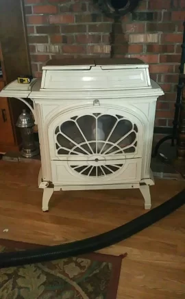

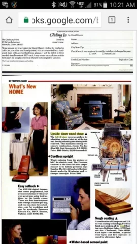

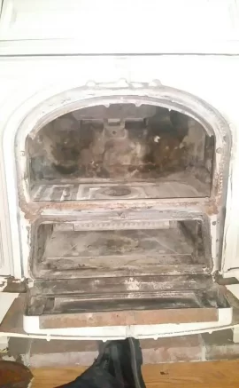

I recently purchased a upland Am 40 I replaced a pellet stove I have had no luck finding and information on the stove. It is a catalitic stove and I have no experience with them. I am hoping someone has a owners manual they could send me. I have contacted Nu-Tec who have sold to us stove who do not have any info on my stove.

I got it hooked up and the handle that opens the flu was broken. not that big of a deal I just fabricated a new one. It ran us out of the house it was so hot. Temperature is hard to regulate still messing around with the settings I'm thinking about adding a damper in the flu pipe but not sure if I can with the catalitic stove. Any suggestions
Check for air leaks around the door gaskets by doing the dollar bill test.

Re: the stove being too hot, look for anywhere extra air could be getting in- especially the door, as begreen said.
