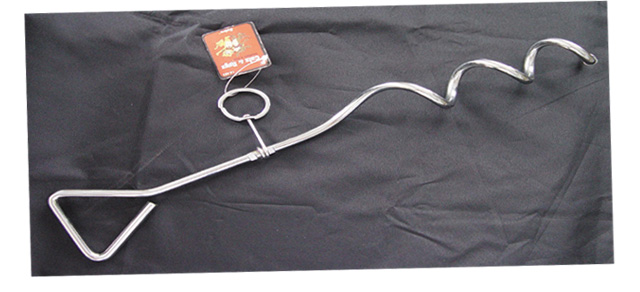

Those shelter logic sheds are pretty darn good quality. We got half dozen of these and some 2" ratchet straps to secure it to the ground
[Hearth.com] Portable Garage for a Woodshed??
Ours came with Anchors, but was having a tough time with the rocky soil......got 2 in the ground, and use the camper as an anchor. The Shelter Logic is pretty strong, but not happy about the skin wearing so soon......ready to split at the seams
