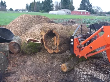

Speaking of splitting large logs on a horizontal log splitter, what tool works best for lifting heavy logs onto the splitter? I have been using a pickaroon. It gives good leverage, but it is hard to keep the log balance while hefting it onto the splitter. Sees a but awkward. Would log tongs work better?
A heavy (8lb) maul is for guys that swing high and slow and let the weight of the maul do the work. That's how my buddy does it. For me it's to heavy. For lighter mauls (6lbs or less), a fast swing is used. This works much better for me. Everyone has a preference. Both will crack open at least some of your oak. In the pics you definitely have some knotty pieces that will be a big hassle. Chainsaw best for those.
Yes, chainsaw might make the most sense for some of the logs. The arborist keeps dropping off logs. He brought more oak a few days ago (from a very sick tree) and some fir today. I am hustling to get this wood bucked, split and stacked before I run out of space. One thing is for sure, I will have some great firewood in a couple years when it is done seasoning.
[Hearth.com] Positioning large rounds on the splitter. [Hearth.com] Positioning large rounds on the splitter. [Hearth.com] Positioning large rounds on the splitter. [Hearth.com] Positioning large rounds on the splitter. [Hearth.com] Positioning large rounds on the splitter. [Hearth.com] Positioning large rounds on the splitter. [Hearth.com] Positioning large rounds on the splitter. [Hearth.com] Positioning large rounds on the splitter.
Those hollows are perfect to start getting your hand splitting game going on.
Those wood donuts are a snap to split with an axe. Drop them on the ground and they will bust apart. This was one sick tree. Hey, beggars can't be choosers. I will take any wood I can get.
