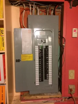

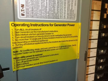

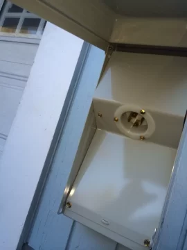

I just got the interlock kit for our electric panel. Now I can turn on or off whatever!
Just plug in a 50 amp breaker and slide the plate up when power is lost then plug in the genny outside the garage door.

I have an interlock like you Don2222, makes life so much easier.
You can get them from HomeDepot or ebay from about $45 depending on your panel.
No more half the house being powered up and much safer.
Your choice at the end of the day..
How do these distribute power to both sides of the panel. It just looks like a metal slider to keep you from turning on the main while the gen breaker is on. ???
In Don222's first picture, the 2 circuit breakers top right go to his outlet box outside his garage.
The only way to turn these 2 breakers on (without bending or breaking something) is to turn off the main circuit breaker in the middle, off and move the slider.
I am not sure if Don has a 220v genie but mine are only 120v so I can only power up the 120v circuits.
In my case, the feeds to both circuit breakers are connected together so I can power up all the 120v breakers in my panel.

Nice.. Not sure if you have a companion EU2000 but that one has a cable that connects the 2 inverter/generators so they act as one big generator. The companion has a 30A outlet on it so I have a cable that connects to this box, http://www.gen-tran.com/eshop/10Expand.asp?ProductCode=53004 at the back of my house.
If you have 2 normal 2000I's then you will need to have 2 15A boxes, one for each generator feeding to each breaker or 2 of the 30A boxes.

That is one advantage in going to an interlock instead of a transfer switch. You can power up all circuits in your panel + sub panel if your generator has the oomph.. My interlock has been inspected by the town and legal, not sure about all states. On my panel it lists the interlock kit that is approved and tested for my panel on the label, that is the one I am using.
