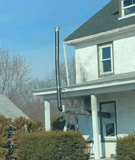

Well my wood stove setup did not meet the high standards of this forum. However having said that, my 1984 Jotul woodstove install worked just fine in a pinch! 4 days of no power here in Central VA some folks still have no power 6 days later! My house was warmer with this woodstove than it is when i have my heatpump running I keep it at 65, my heat pump is super old too!

I am sorry but it doesn't take high standards to see a problem with a black pipe chimney. You really really need to get a proper chimney. There is a very real risk of a structure fire

I'm guessing once you clean it and get a ultra low co2 meter you will get the proper chimney and install...

Idk, that black pipe set up that long of a chimney is terrifying. Especially using it in the single digits, that flue gas will cool down and condense about 4feet into the pipe outside. Thats going to be a TON of creosote build up. You could burn your house down within a month with a strong chimney fire and being so close to the house.
I get “emergency” situations. But for what this cost you should have bought a small generator and waited to install this later, properly. You might just find yourself in a much bigger emergency with this set up.

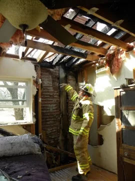

Recently saw this. It's never a problem until it is. Pyrolysis can take time, but when time is up, it happens quickly.
[Hearth.com] Power outage
Here is another. It took 40 yrs for this to happen.

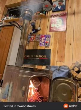

Someday when I’m on breathing oxygen and too cheap to heat the outdoors, I’ll be heating like this too. Everything will get that smoked flavor as your taste buds fade. Win win.
Draft? Nah, don't need that.. horizontal flue is perfectly fine... I even insulated it...
  • Haha
Reactions: D. Hermit
Posted in the fb wood heat page. I cant see anything wrong here. hahaView attachment 290551
Whoa... that looks very much like my 1st wood burning setup many moons ago when I was young and foolish (heavy on the foolish). We had a stove in the basement with the flue pipe going horizontally thru a crawl space, directly under unshielded joists, then up to about eave level... single wall stovepipe all the way. Just for fun, I grounded the array to the gas meter. The gas company had words with me about that. Best of all, I lived to tell about it.
