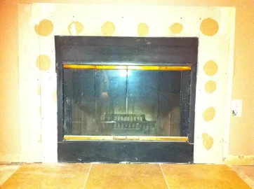

    My husband and I inherited our fireplace from the original owners of our condo. We are remodeling and have torn out the surround. We want to replace it but aren't sure how much non combustible material bust be in the sides before we can use wood. Everything I'm reading says that we need to follow manufacturers instructions, but we don't have that paperwork and we can't find any identifying information on the fireplace. Any tips on how we. Can find out how we need to approach this? Thanks for any help!!

    Look carefully around the inside frame of the door for a manufacturer's tag indicating the brand and model. Based on the picture it looks like there is sheetrock right up to the fireplace. Is that correct? If so, that is combustible and would have the same requirement as wood trim.

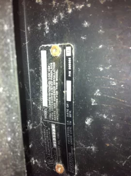

    Good call! We did some looking and here is what we found:
    UL Fireplace number U135282
    And yes they have sheetrock all the way up to the fireplace unit. It's been that way since the house was built. Can we assume that this was safe per the original manufacturers instructions?

    Looks like it's a Superior fireplace, but I can't read the model.

    Model # RD3300 is what im seeing. Its really hard to read! Could the 3's be 8's?
